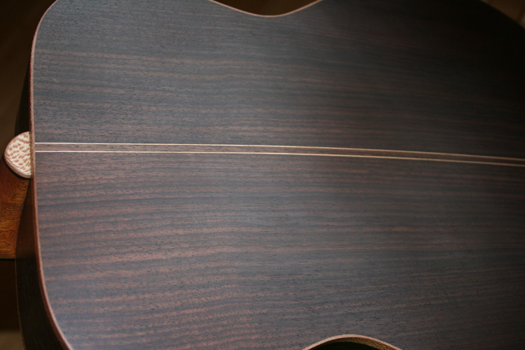

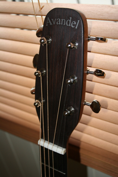

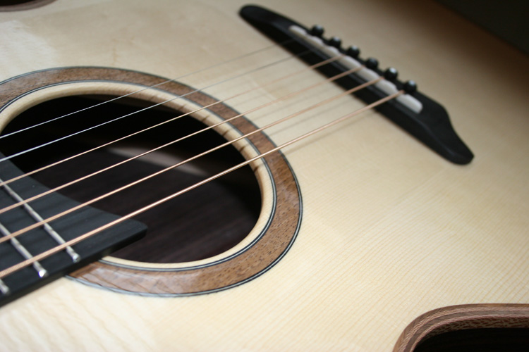

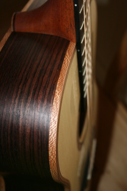

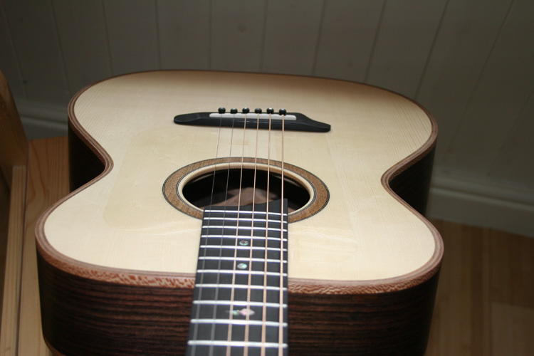

Thought I would post a few pics of this one, as it is so conventinal, its unconventinal for me
EIR Back and Sides
Euro Top
Mahogany Neck
Ebony FBoard and Bridge
Walnut/London Plane/Walnut Purfling
Plane Bindings
Walnut Rosette

Russell, Wow.
Love the finish. What did you use?
The wood looks like it's still alive!
Those bindings sure don't look plane.
Where would one get London plane bindings?
Fabulous job!

Russell, what can I say, you know what I think of your guitars, wood combinations and overall finish is up to your usual stella standard. That, my friend (And all you others out there)is what a guitar SHOULD look like. Oh, and your photography is getting better too!
Right tomorrow I go out and rip some bindings off of my London Plane side sets to go on my Mad Rose guitar. Hope I've got enough to do the purfling as well. Inspiring.

Russell thats a great looking guitar!
Are the bindings Sycamore?

Many Thanks Guys
Wade
It is a Shellac and Danish Oil finish not everyones cup of tea, but nice if you really want to see the wood.
Wade\Lance
I know it as London Plane or Lacewood over here, but I think it is the same wood that you call Sycamore in the US. If you can't find any wade let me know and I can send you some as I did a run of 5 guitars in it so have plenty of pieces around to make bindings from.
If your short on Plane let me know, thanks for your comments.

The scalloping came about originally because a customer who has bought a few guitars from me wanted it as he somehow anchors his hand on the saddle when he is playing what he calls "Lute Style Patterns" (He is a much better player than me so I am not sure what this involves?) and I just kind of like the look, and the customer for this one said he wanted Euro, Ebony, Mahogany and EIR and he would leave the rest to me, so I did it on this one just to look a bit different.

Russell,
Fabulous as usual. Really nice wood combinations - very elegant. Did you cut your own purflings?
Love the subtle sunburst finish on the top
Is that an X braced back I see in there with what look like "you know what" shaped profiles? Love it.
How does it sound - any sound samples upcoming?Dave White38831.6504513889

Hi Dave
The purflings where bits I had cut off when profiling the sides on other guitars, I glued them up with waterproof PVA and then cut them into purflings on the bandsaw. You do see a Parabolic (Sorry Howard) X Brace on the back, I've don it on the last 3 and I seem to get a nicer dome and to my ears it aids the projection.
I have quite weened myself off the scallops on the top bracing, but I not scalloping anywhere near as deep these days.
In terms of sound nice balance rumbling base and bright trebles. I will see if the customer will do a file as it left this morning.

Forgot to say thats as dark as I like my Bursts

Looks great - I love to see that kind of fleck in well quartered wood - on the sycamore binding. Nicely done.

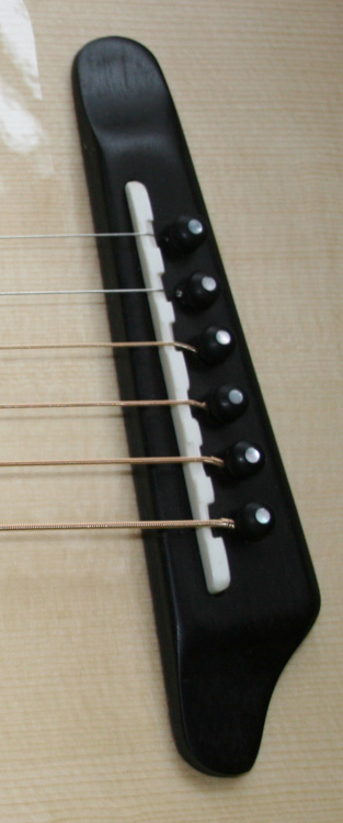

Russell, that's a beauty! Any chance of a straight on shot of your bridge? Looks like a really nice design.

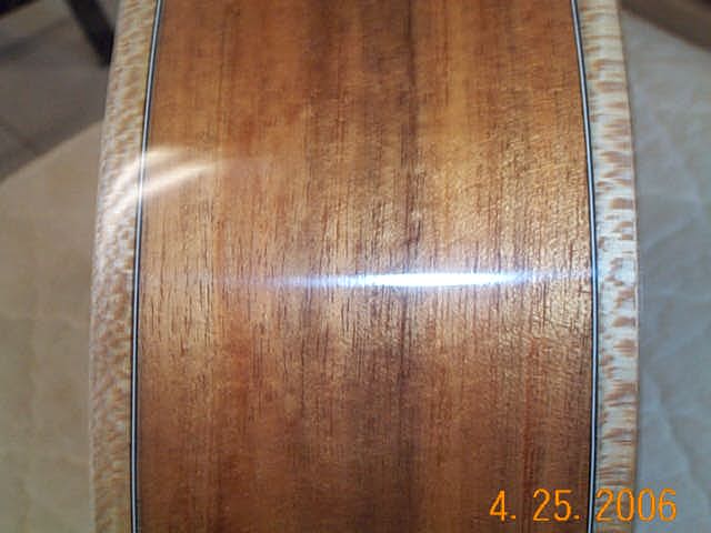

That London Plane sure looks like the quartersawn sycamore we have over here. Here is a shot of one I am just finishing up, Black Acacia/Englemann, with the sycamore bindings.

Dave beat me to it, nice subtle sunburst anyways!
Russell, congrats on that really elegant guitar! i really love your combo, it's got class! and I love it!

Dave R, your a tease. That looks sooooo nice, any more pics please.
PostPosted: Mon Apr 24, 2006 7:13 am
Thanks Rod! It'll be a couple of weks before it is finished. I just sprayed the neck this morning and need to give the nitro a little time to cure before sanding and buffing.
Russell, didn't mean to step on your thread, just when I saw your binding after looking at mine this morning I thought I'd share the pic.

Russel, a very refined guitar, elegant in a word, great combinations enhanced by a perfectly subtle finish. Dripping with class mate, well done
Oh and Dave, your blackwood sycamore combo is no slouch either Great work Guys.

That Combination looks really nice. Is this what you are after on the bridge ?
PostPosted: Mon Apr 24, 2006 7:17 am
Yeah, that's what I was talking about Russell! That looks very elegant to me. I like the taper from bass side to trebel. Looks like it would reduce some of the mass we all worry about too.
Thanks for the extra pic.

Man, Russell, that is one nice instrument!! There's nothing about that one I don't like. Beautiful wood combination.

Russ, that's really nice-- and I, too, like the wood combo.
Shellac / Danish oil, huh? Do you seal first w/ straight shellac? And the top looks "glossier" than the sides / back. Is that an optical delusion?
